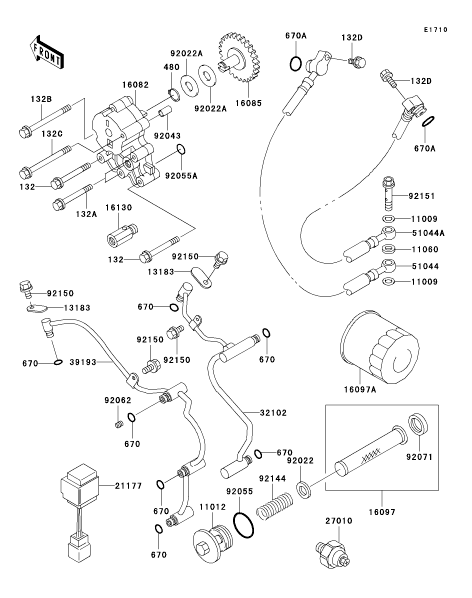

What is it and where is it? Check the diagram below (courtesy of Kawasaki) which shows part number 16097 (bottom right in the box). That's the screen which 'pre' filters oil before it reaches the oil pump and spin on filter. It's also the best oil drain you have with the opening sitting lower than the normal oil drain plug in the center of your crankcase.

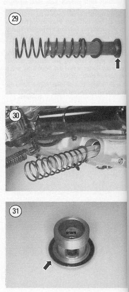

29 Screen w Spring & Washer
30 As Assembly Sits In Case
31 Plug Assembly

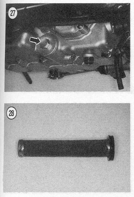

27 Arrow Points to Location
28 Photo of Screen
